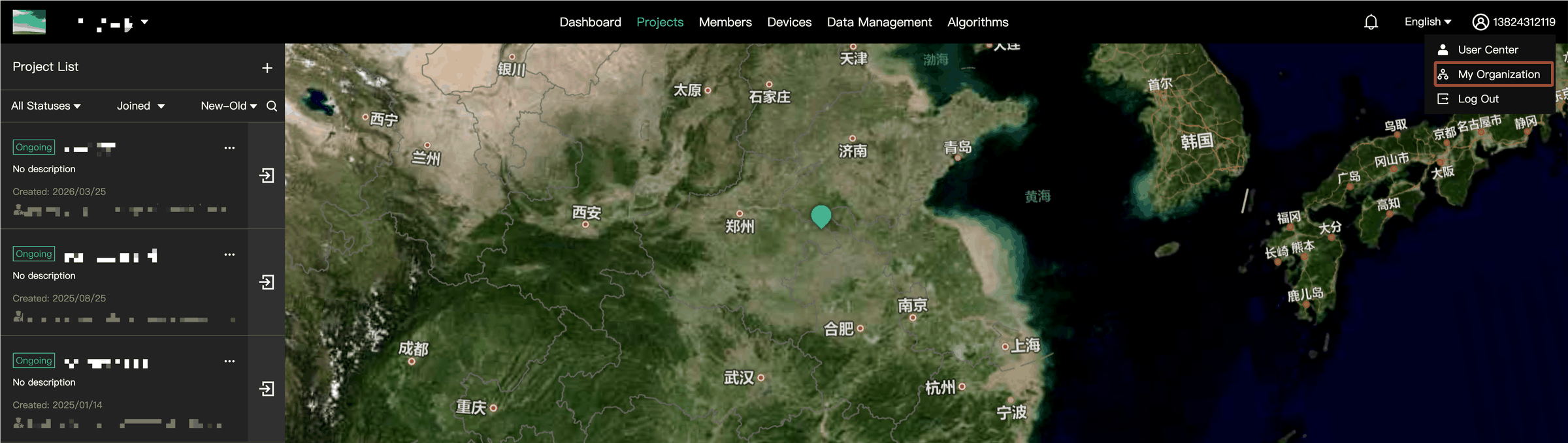

Open My Organization
Open My Organization.

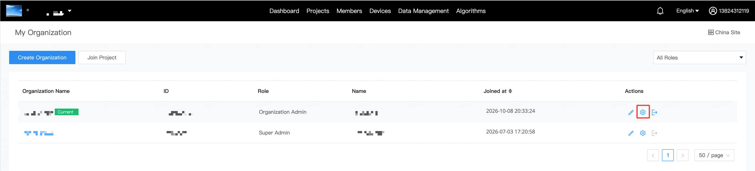

Open organization settings
In the organization list, click the Settings icon in the Actions column for the organization you want to configure.

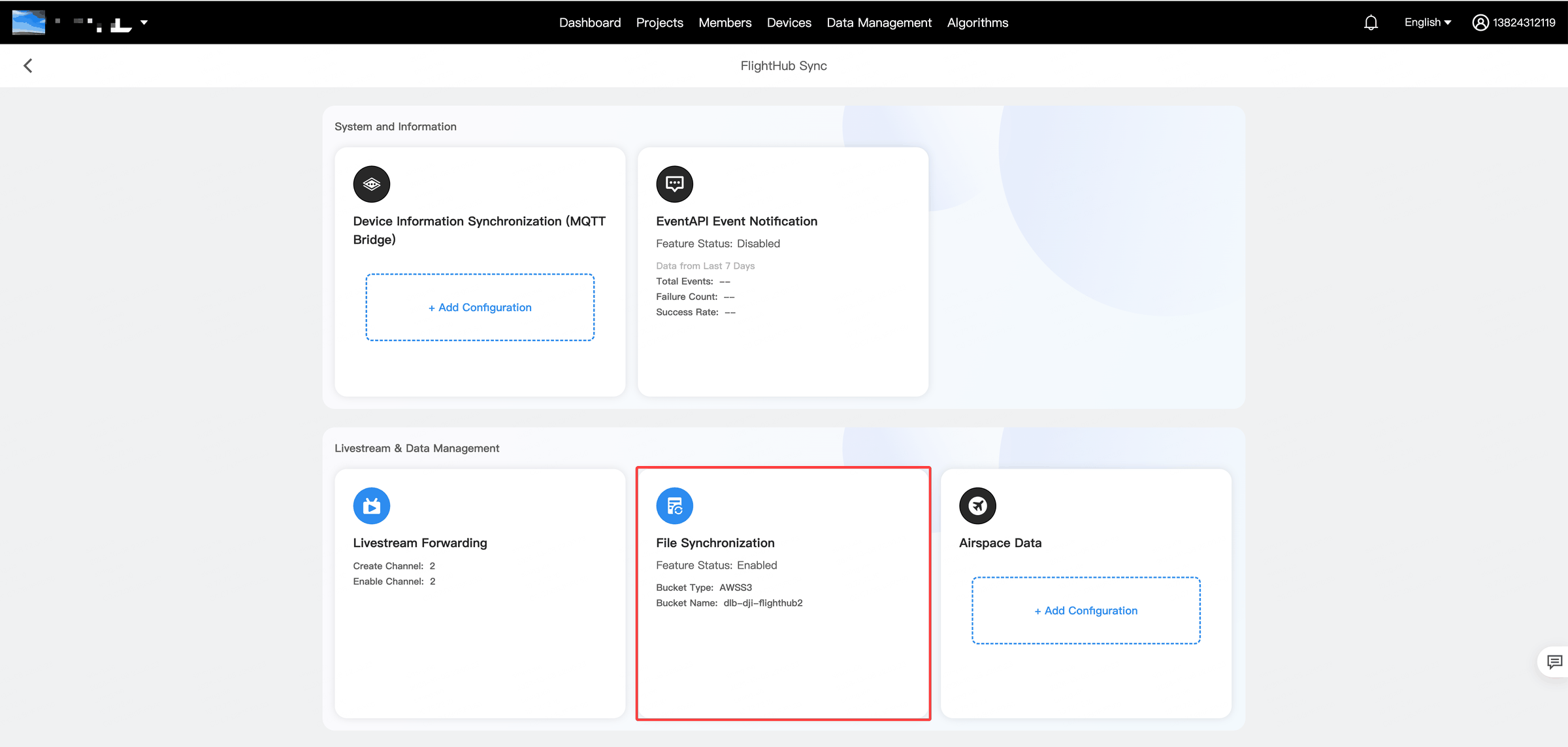

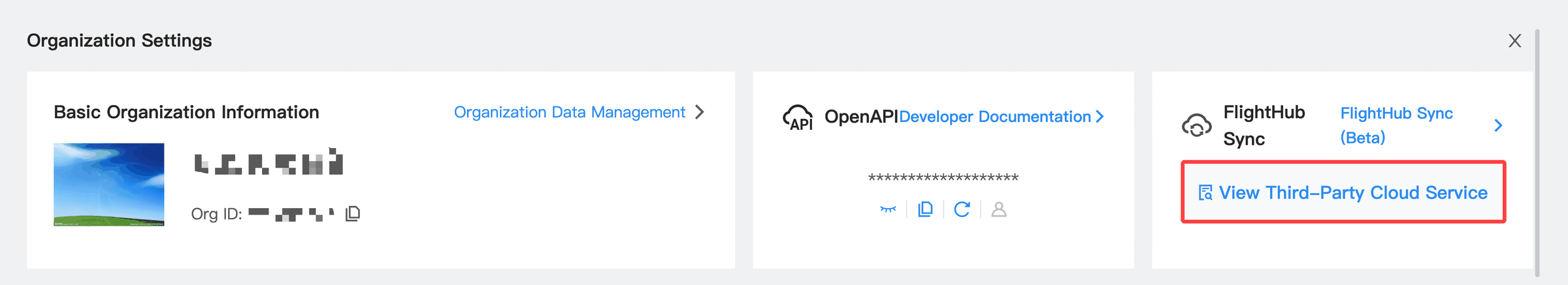

View Third-Party Cloud Service
Click View Third-Party Cloud Service.
Open File Synchronization
Open File Synchronization.

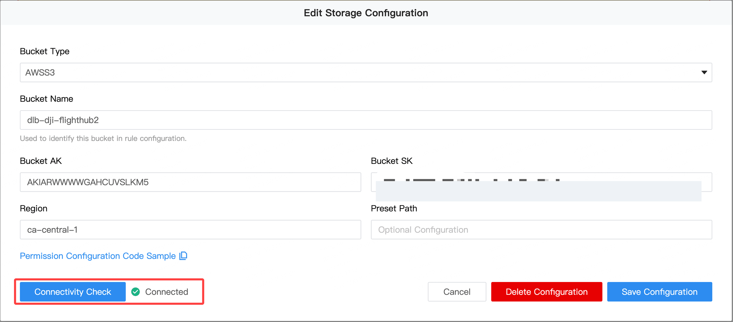

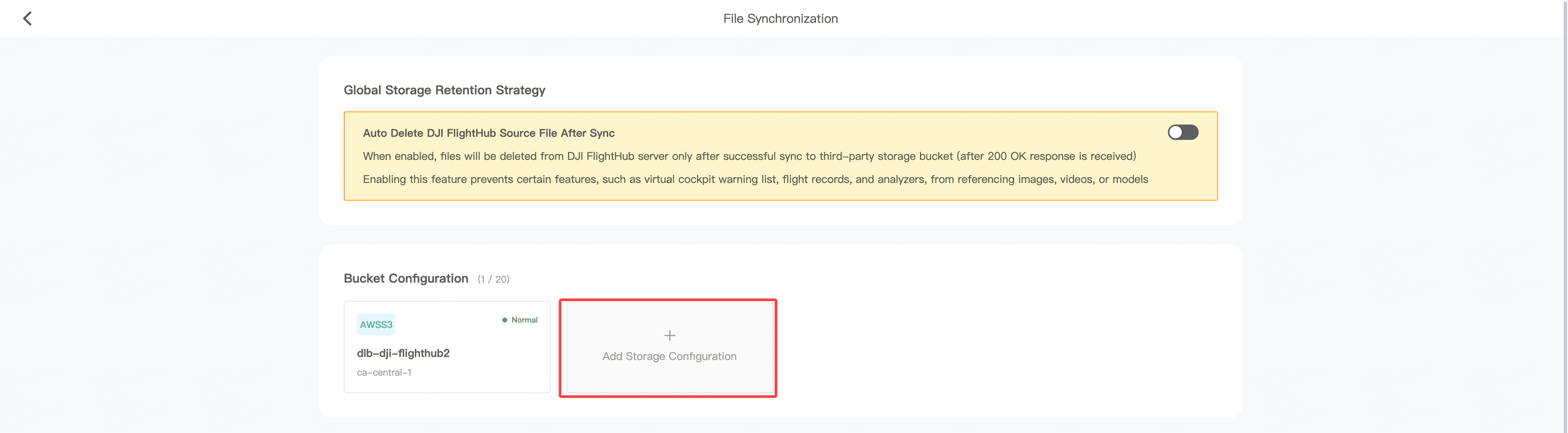

Add Storage Configuration
Click Add Storage Configuration.
Enter bucket parameters and check connectivity
Enter the following storage configuration:
Bucket Name: dlb-dji-flighthub2
Bucket AK: AKIARWWWWGAHCUVSLKM5
Bucket SK: Contact DroneLogbook to obtain the secret key.
Region: ca-central-1
Click Connectivity Check to test the connection. Once the status shows Connected, click Save Configuration.

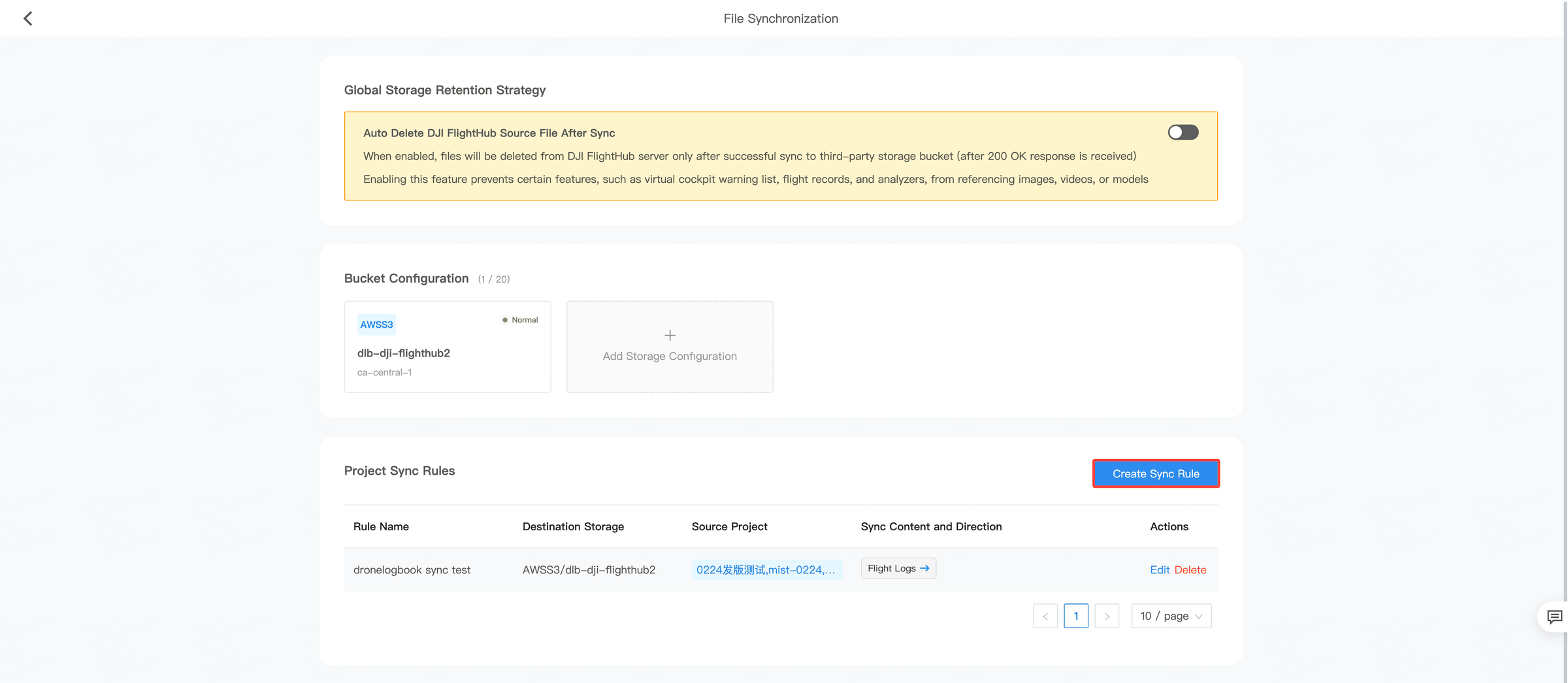

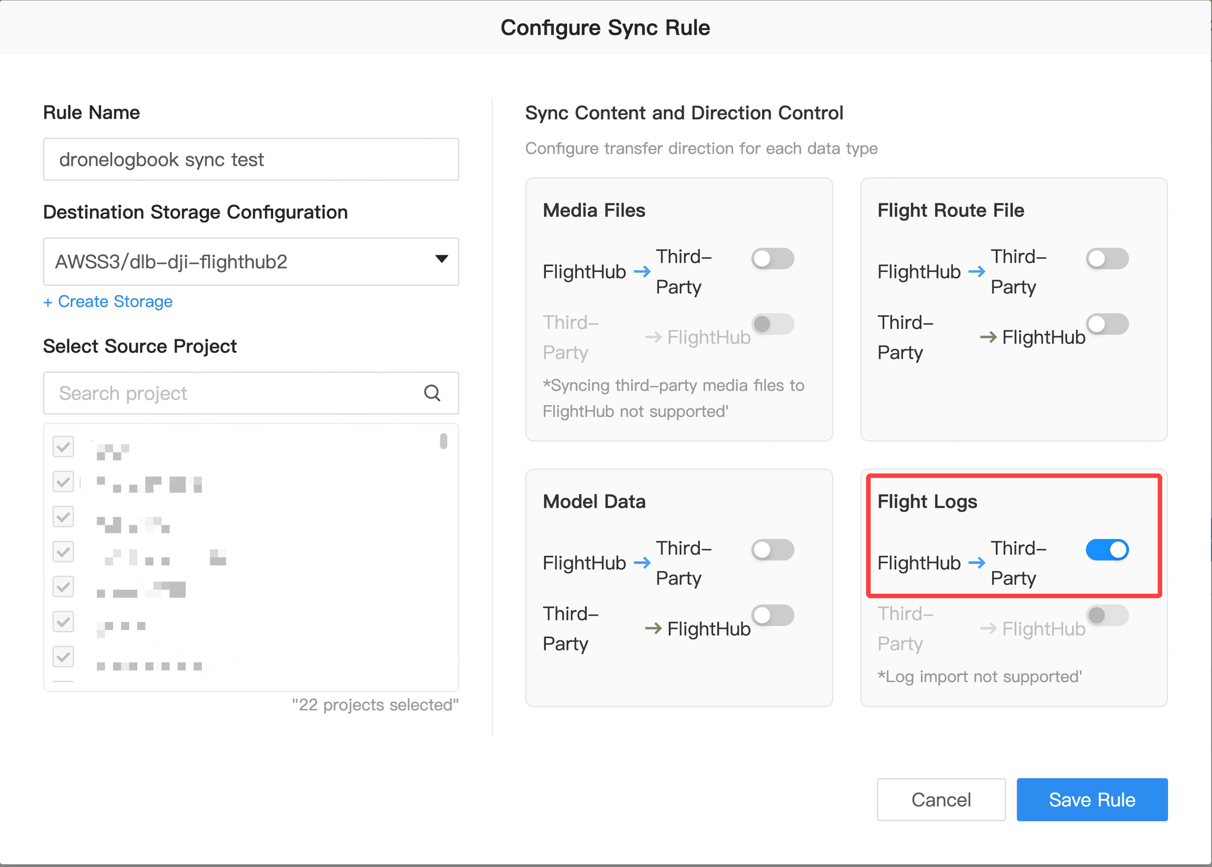

Create a sync rule
Click Create Sync Rule.
Create a sync rule
Create a sync rule
Select projects and flight log direction
  1. Under Destination Storage Configuration, select the storage configuration you just created.
  2. Under Select Source Project, select the projects you want to sync.
  3. Under Sync Content and Direction Control, enable FlightHub → Third-Party for Flight Logs.
  4. Click Save Rule.

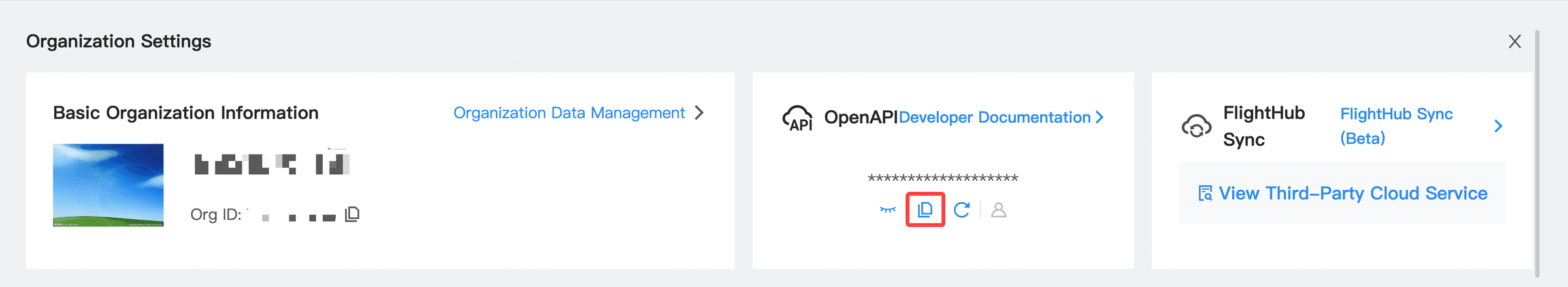

Copy the organization key
Copy the organization key from the Organization Settings page.

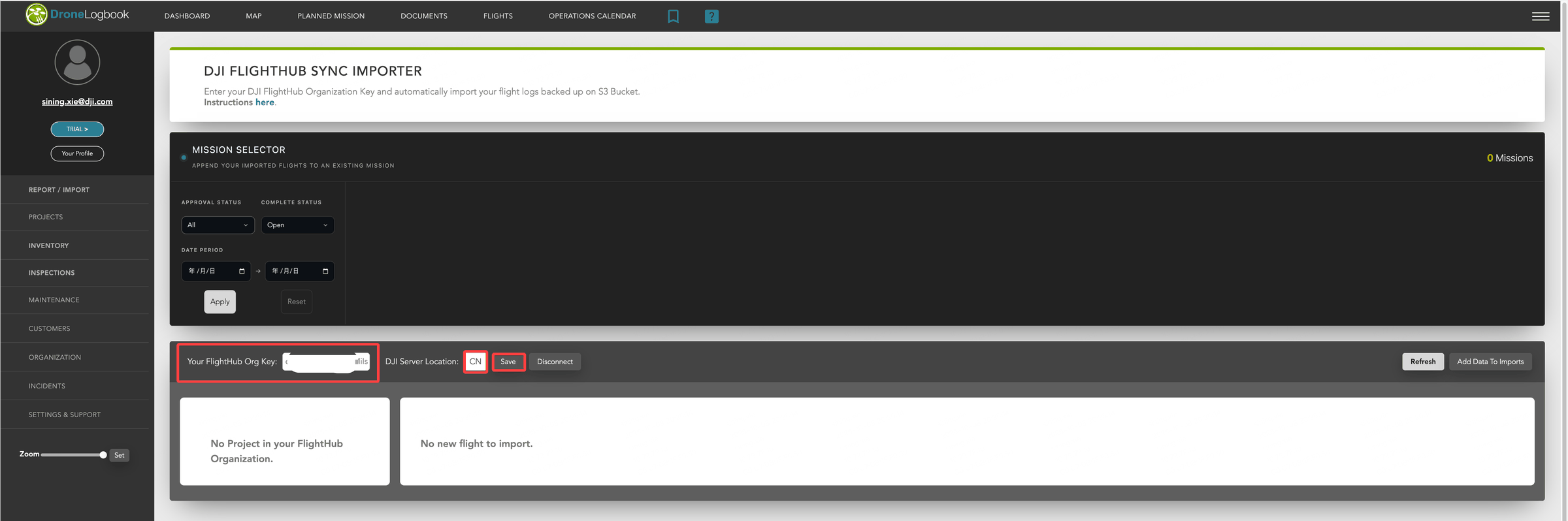

Configure DroneLogbook Import
  1. Open the DroneLogbook Import page.
  2. Enter the organization key in Your FlightHub Org Key and select the appropriate DJI Server Location.
  3. Click Save.

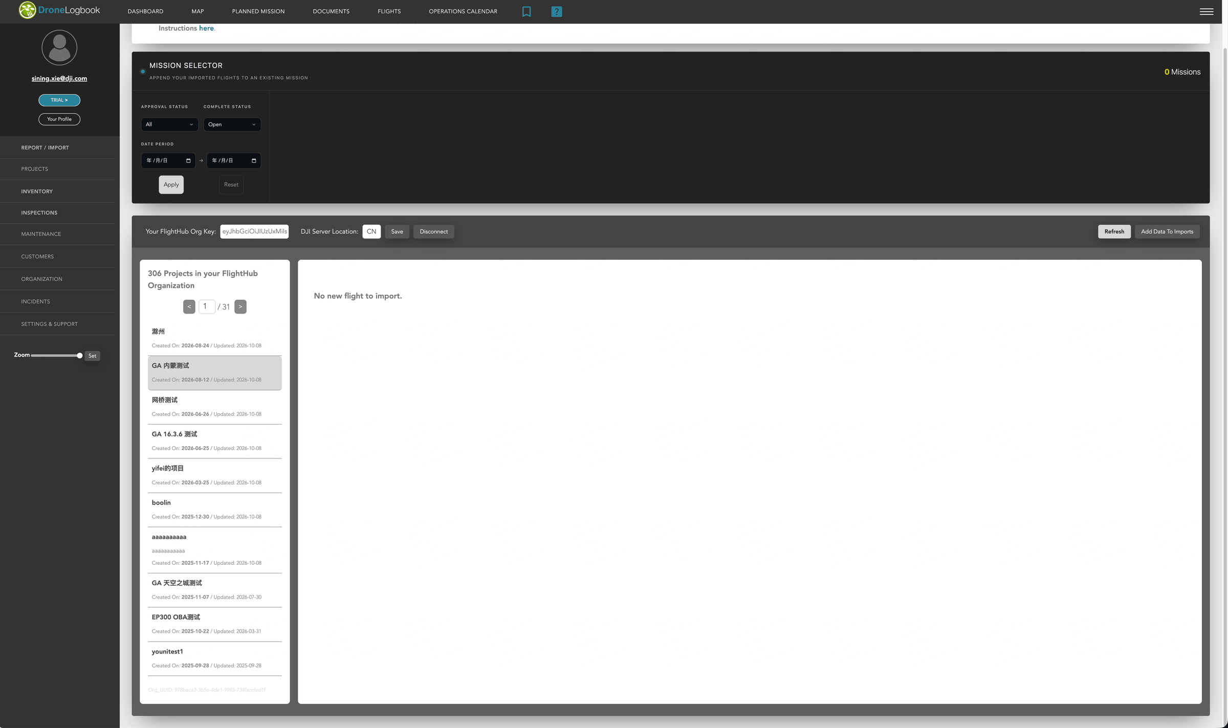

Refresh and select logs to import
  1. Click Refresh.
  2. Select the project you want to sync.
  3. Select the flight logs you want to import.
