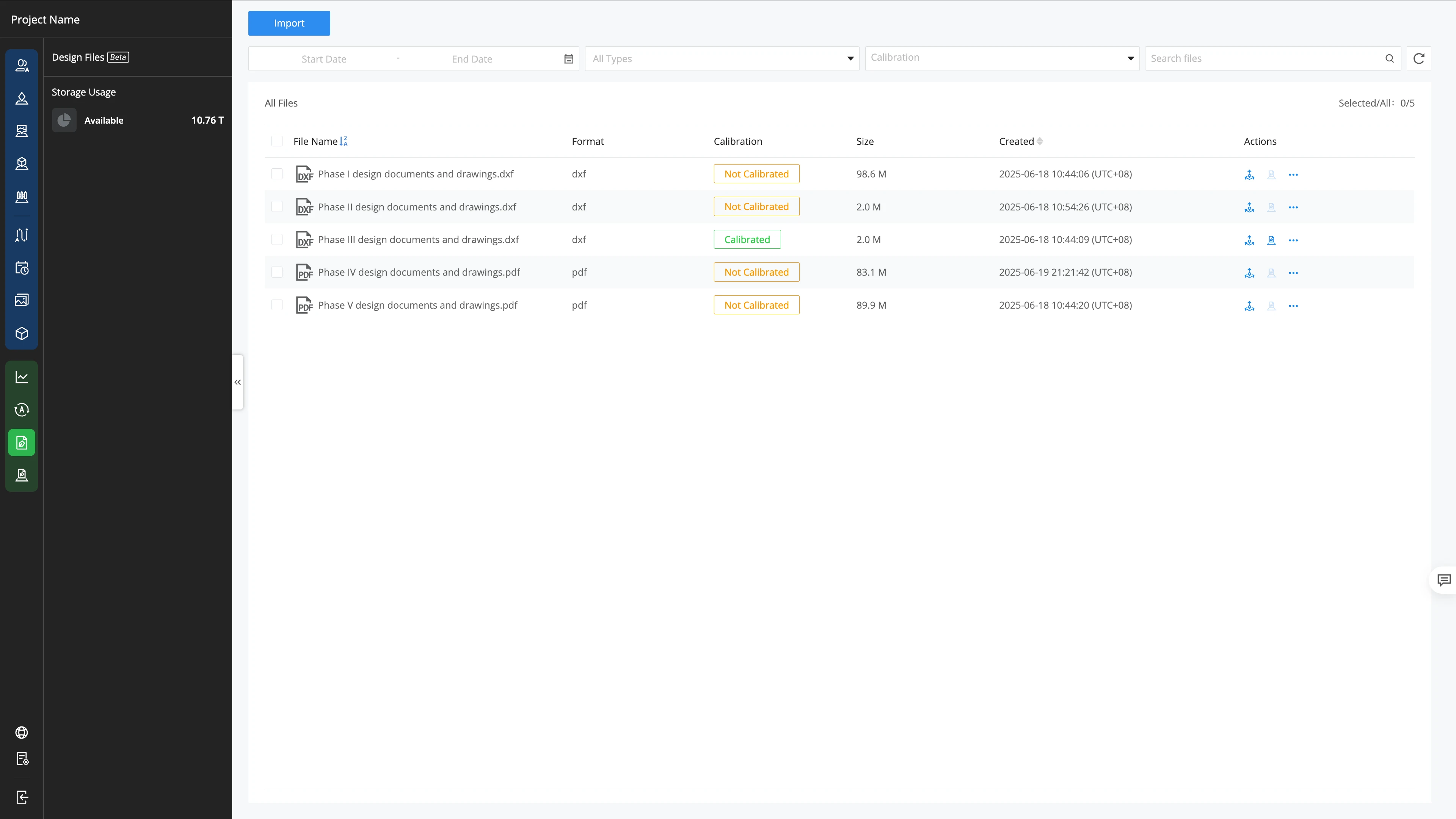

DXF or PDF design files can be imported and displayed within the FlightHub 2 project map and analyzer. You can upload DXF files with 3DFACE entities. The system calculates volumes and visually tracks construction progress based on your selected models and design files.
    Note:
    • Multi-page PDF file can be uploaded and be displayed on the map after matching points are set and calibrated in the design file management;
    • DXF files less than 100 MB can be uploaded and be displayed on the map after matching points are calibrated or coordinate system is converted in the design file management;
    • The above design files can only be referenced by the analyzer after calibration is completed.
